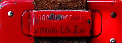

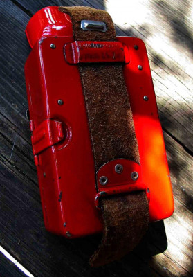

I love dug up items and this is great bodenfund flashlight! Here is my new one. Ennwell?
Hi Filip,
This red Ennwell modell firefighter Flashlight yours is made in''US'' zone Berlin Beginning in 1946/1953 the U.S.Army started to buildt ist own firefighter`s Department in the Occupation Zones German...here is mine,made also in the US zone ''Ennwell'' similar to yours.
