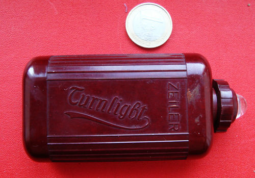

This small Zeiler "Turnlight" bakelite lampe just been sold at eBay for really high price.
Does anybody know this type of Zeiler's serial number, or when was it produced?
Thank you in advance.

Yes this is the first and the last New flashlight production by Max Zeiler (Zeiler Turnlight GmbH) after the War in 1947 to 1953. In the new Factory in the West Berlin Germany.
End of 1953 is the new factory in Regensburg Germany go bankrupt :( Finally the end of Zeiler flaslights.

Dank U Schijnwerper. It is hard to find info or catalogue picture on the web about this Zeiler Turnlight. I guess it was produced in limited edition.
Does anybody else in here have this type of Zeiler bakelite turnlight?

I found in the meantime an old catalogue by Kleinschmidt & Co. Stettin ( now Szczecin Poland) from August of 1933, where "Zeiler Turnlight" batteries were offered. So this Turnlight brand was existed in 1933 for sure. On the other hand, "Turnlight" brand was one of the several battery mark of Zeiler AG Berlin among others: Adico, Baxon, Cordesia, FOS, Fyrtornet, Gallaphos, Intelcos, Majakka, Orolite Battery, Silver Light Battery, SZ, TB The Battery, The Britannia Dry Battery, The North Light Battery, Tropical, Turnlight, Weissblitz, Weltall, Weltmusik, Weltrenner.

Yes well i tried to explain, is something confused, by used an old name by the Zeiler turnlight after the WW2 War in Germany.
Yes indeed Max Zeiler came with the Zeiler Turnlight idea by in 1920's.
Turnlight is an Registering patent by Max Zeiler him self 1922.
Others factories used with permission by Max Zeiler Patent also the Turnlight construction idea.
Is nothing more than a 4,5 volt's battery with a paper cardboard box an it.
But why used Max Zeiler an old name Turnlight again, after The War from a new produced flashlight in Bakelit, nobody knows so far.
Dear produced as we know so far' 2 type's of flashlight's afther the War in Bakelit.
From 1947's The New Turnlight's. And the old type Zeiler Nr 4350 D.R.P. type flashlight, but without the type nummering 4350 D.R.P.
In 3 new fresh colours Red Green and Black and dark brown .

Thank you. It would be nice if you would share with us your documentation of Max Zeiler Taschenlamp production from 1947, since there is nothing available on the internet. Do you have Zeiler Taschenlamp from the above era?

Well i have no documentation by my self, this information came from a great dutch flaslight collector in the world !
Hey studying a lot of years to find any information and documentation about it hey can find!
So no there is nothing left available left from date time on the internet.
No i dont have this type of flashlight in my collection i dont like him :) En i was no the only wan it was no succes, this project failure.It was a very difficult time in this day's after ww2 in Germany, dear left 2 factory's 1 in east Berlin an Russia zone and 1 in Austria Linz.
Dear start all over again whit a new factory in West Berlin 1947 then left near a new factory in Regensburg.
I collect only the Wordl war 2 German flaslights By Zeiler Pertrix and Daimon.
