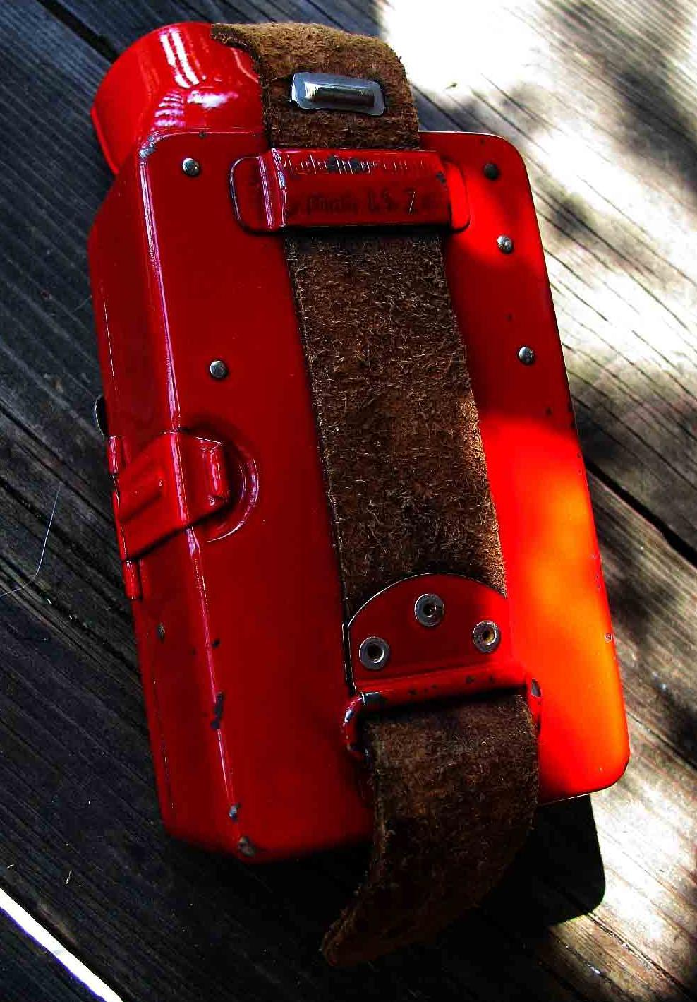

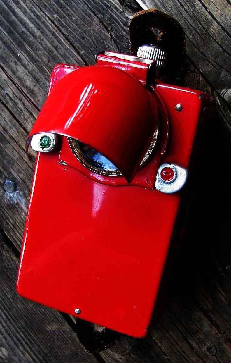

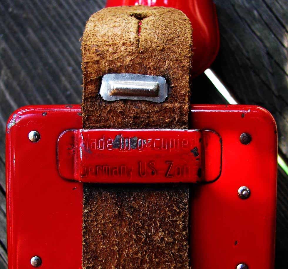

I love dug up items and this is great bodenfund flashlight! Here is my new one. Ennwell?

Hi Filip, :)
This red Ennwell modell firefighter Flashlight yours is made in''US'' zone Berlin Beginning in 1946/1953 the U.S.Army started to buildt ist own firefighter`s Department in the Occupation Zones German...here is mine,made also in the US zone ''Ennwell'' similar to yours.
