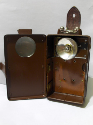

Thankscustom schreef:for more to tell you I' need pictures from inside + rear this pertrix lamp.
@Fero,
I see on the characteristics of This pertrix lamp is probably made in a pertrix factory in Austria 1940 used by the Wehrmacht.
@custom,custom schreef:@Fero,
Thank you!

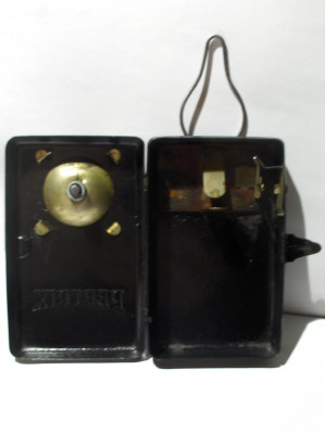

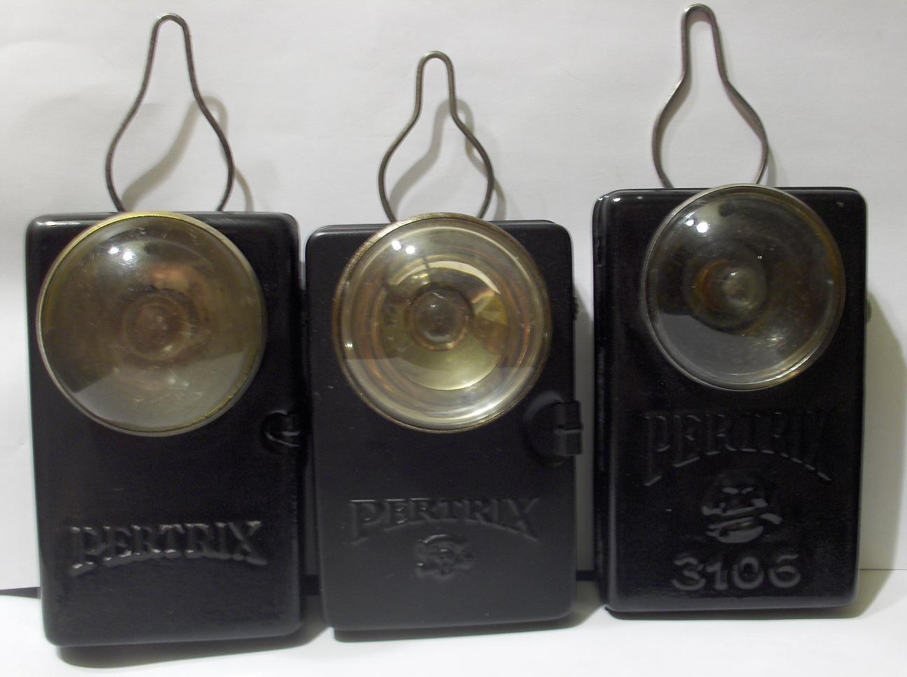

Hi,
Who used this Pertrix?
Thank you for your answer.
Fero
Fero
HI
Used by the ''HJ'' is this lamp repainted?? Normally is the brass section also painted.okay

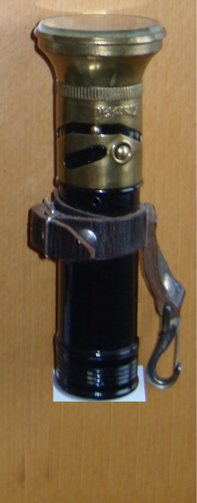

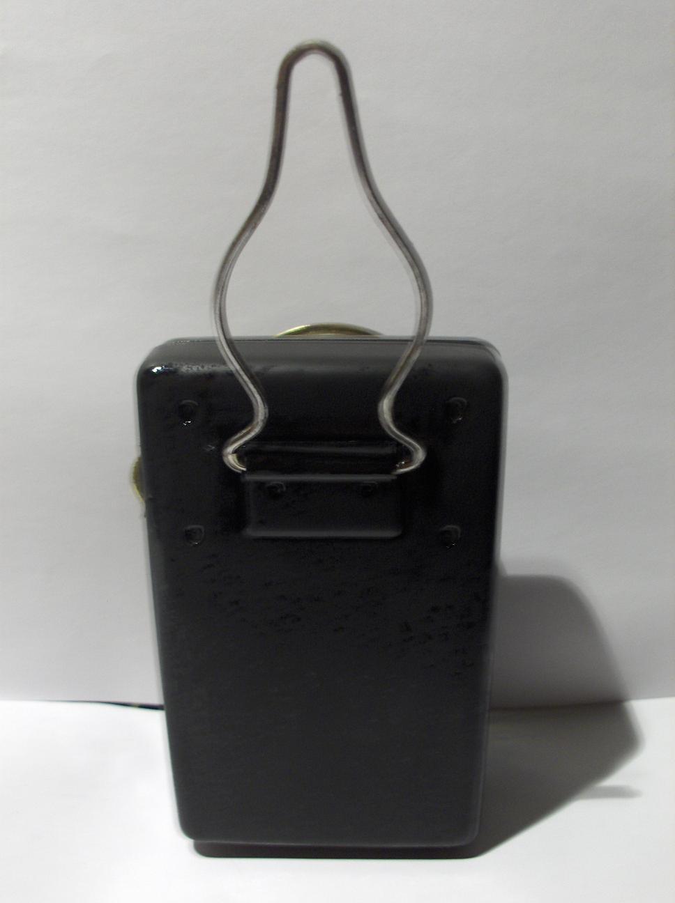

Hi, can anyone explain in what case this detail/part was used for?
I think place for a' reserver bulb

No is a place for the lamp bulb Filter, for the stirmlampe.You have a Blue and yellow and red filters.
This Stirmlampe is use by Radio operators an the front, and by many other.
You can this battery box also use as a flashlight
whit the color filter.
This is my collection flashlight special for the Stirmlampe etc.
Laatst gewijzigd door Schijnwerper op 09 feb 2013, 04:30, 1 keer totaal gewijzigd.

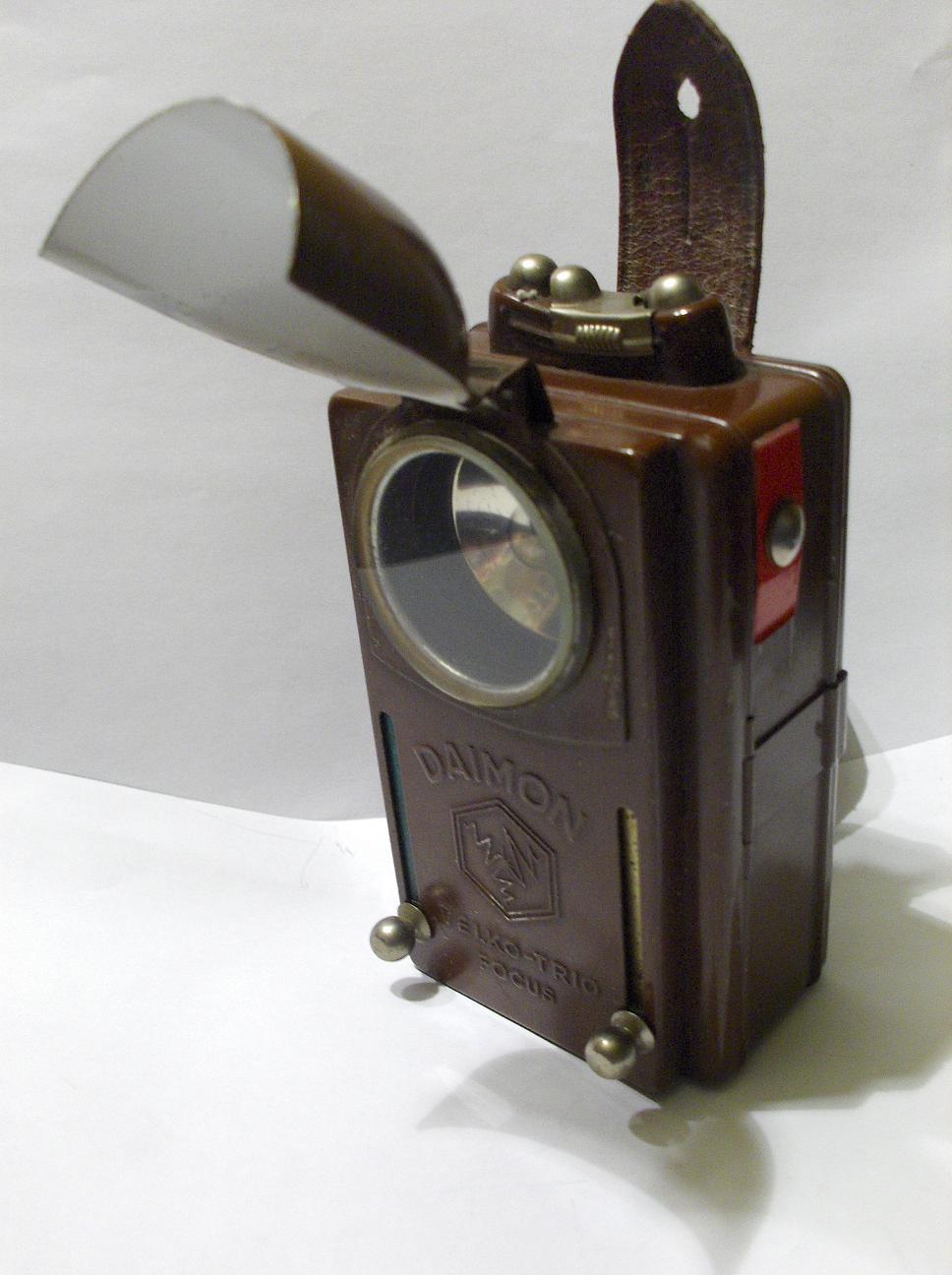

Hi,
New Daimon Telko-Trio Focus (HJ) 1936?
Fero
Fero
