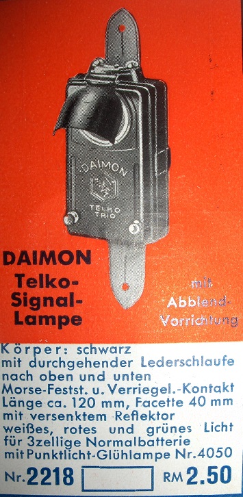

Fero
Berichten: 365
Bericht door Fero »
Hi Andrew,
Good job! :wink:
This manufactured since 1936 Daimon Telko flashlight.
Type number: 2218
Of course, the Wehrmacht also used one.
Regards,
Fero
Dima
Berichten: 198
Locatie: Russia, SPb
Bericht door Dima »
Hi
perhaps Type number is 2213?

Hi Fero,
May be numbers differ due different markets or to make it easier for customer to avoid ordering wrong flashlight.
I got two proofs from finnish and czech catalogues with numbers 2213 and your pic is from german one.
Fero
Berichten: 365
Bericht door Fero »
Hi Dima,
Such a difference also occurs at Pertrix. :wink:
German catalogs show this type number. _/-\o_
Fero
